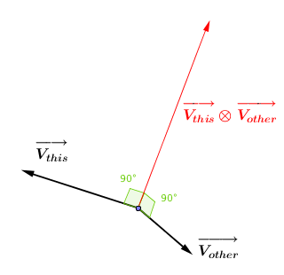

The cross product of this vector and the specified vector.
The cross product is a vector orthogonal to both original vectors. It has a magnitude equal to the area of a parallelogram having the two vectors as sides. The direction of the returned vector is determined by the right-hand rule. Thus A.cross(B) == -B.cross(A).
Vector crossProduct = thisVector.cross(thatVector);

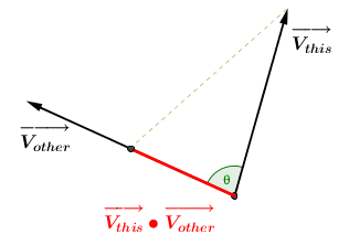

float dot(const Vector & other)The dot product of this vector with another vector.
The dot product is the magnitude of the projection of this vector onto the specified vector.
float dotProduct = thisVector.dot(thatVector);

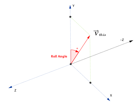

float roll()The roll angle in radians.
Roll is the angle between the y-axis and the projection of the vector onto the x-y plane. In other words, roll represents rotation around the z-axis. If the vector points to the left of the y-axis, then the returned angle is between 0 and pi radians (180 degrees); if it points to the right, the angle is between 0 and -pi radians.
Use this function to get roll angle of the plane to which this vector is a normal. For example, if this vector represents the normal to the palm, then this function returns the tilt or roll of the palm plane compared to the horizontal (x-z) plane.
float rollInRadians = thatVector.roll();
