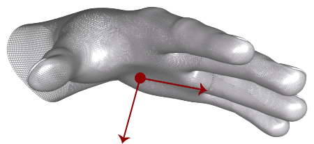

Hand.palmNormal
Type:number[] - a 3-element array representing a unit direction vector.
The normal vector to the palm. If your hand is flat, this vector will point downward, or “out” of the front surface of your palm.
Palm Vectors
The direction is expressed as a unit vector pointing in the same direction as the palm normal (that is, a vector orthogonal to the palm).
var normal = hand.palmNormal;
