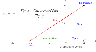

Draw Tracking Data over Image
It is reasonably straightforward to draw representations of the Leap Motion tracking data over the camera image. If you have drawn the raw image data to a bitmap, you can find the pixel corresponding to a Leap Motion position using the warp() function.
Converting a position in Leap Motion coordinates to horizontal and vertical slopes (from the camera perspective) requires knowing how far the cameras are from the origin of the Leap Motion coordinate system. For the current peripheral version, the offset on the x axis is 20mm to either side. The cameras are on the x-axis, so there is no z offset. The slope is simply the distance from the camera in the image plane - the x-coordinate for the horizontal slope; the z-coordinate for the vertical slope - divided by the distance to the image plane, the z-coordinate. The following diagram illustrates the geometry for the horizontal slope:
https://di4564baj7skl.cloudfront.net/documentation/v2/images/Image_Slope.png
The calculation is shown for the left camera; add the offset distance instead of subtracting for the right camera.
Once you know the ray slope values, you can get the pixel coordinates using warp().
Note: The offset can be different for different form factors of the Leap Motion controller, but there is currently no way to get this value from the API.
