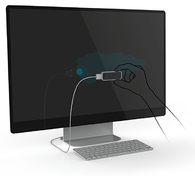

Recalibration
If the sensors on the Leap Motion controller are knocked out of their initial alignment, the device must be recalibrated. Symptoms that may indicate the need to recalibrate include:
  • Persistent jumpiness
  • Frequent discontinuities in the tracking data
  • Aberrations in tracking data that occur only in certain areas of the field of view
  • Poor tracking range
You can look for these symptoms using the the Leap Motion Visualizer.
We also recommend recalibration, using a mirror, if you mount your Leap Motion controller under a piece of glass or other IR-transparent material.
To recalibrate your Leap Motion controller:
  1. Open the Leap Motion Settins application using the icon menu on the Windows Taskbar or Mac Finder bar.
  2. Select the Troubleshooting page.
  3. Click the Recalibrate Device button.
  4. Follow the on-screen instructions to perform the calibration procedure.
https://di4564baj7skl.cloudfront.net/documentation/v2/images/Leap_Recalibrate.png
You will need a flat, reflective surface. A mirror is ideal, but many other reflective surfaces like a flat screen monitor will work accetably as well. During the procedure, hold the Leap Motion Controller so that the LEDs shine on the reflective surface and are reflected back into the top of the device. The calibration window displays a disk that moves as you change the angle between the surface and the device. Rotate the controller to move this disc so that it “paints” the window. Moving the Leap Motion Controller up and down or side to side does not adversely affect the calibration, but calibration requires rotation.
