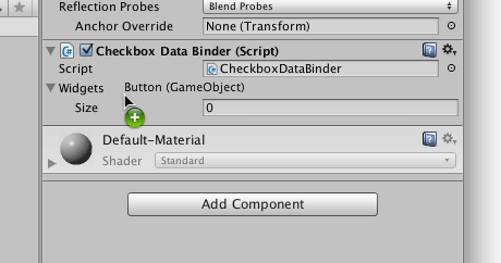

After attaching the data binder script to an object in your scene, you must drag the Slider Top component from the DemoSlider instance in the scene to the Widgets property in the Inspector panel for your data binder script.
https://di4564baj7skl.cloudfront.net/documentation/v2/images/unity/Widget_AddToDataBinder.png
