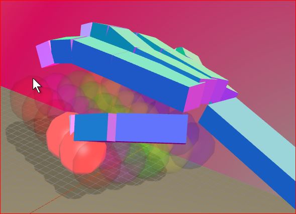

I have started investigating this idea - using the Three.js JavaScript library. Here is a screen capture of what I have so far:
One item of interest in the demo is it goes against the typical way in Three.js - and many other apps -
use to interact with objects which is with a ray caster. Casting rays works well, but it often means that you have to get the angle of the ray just right.
My guess is that guitar players form innumerable angles when they compose their fingers into a chord. Arriving a a typical solution is doable, but will eventually involve gathering huge amounts of statistics in order to discern what the typical patterns mean. This would follow the ways Google have created to translate languages - by keeping stats on two and three word combinations of a huge body of data.
Using ray casters is not wrong, I just think it might be interesting to explore other means. One method is to see if one object is inside another object. In a previous release I tried the Three.js isInterestionBox feature, but this was a fail when the button faces are non-orthogonal with the world coordinate system. In the latest release, the buttons are spheres and sphere.intersects( sphere ) appears to be working fairly well.
If you play with the demo, you should be able tp make the buttons light up like a Christmas tree.
As you move your hand up and down the keyboard gets further and closer to your hand. Nonetheless it is still virtually impossible to hit all thirty keys. So there's a a ton more things to be done.
