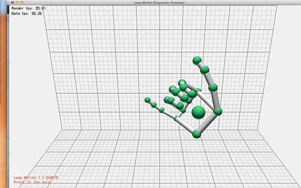

devguide/../../../images/Visualizer_Hand_Model.png
Explore the behavior of the new hand model in the Diagnostic Visualizer
