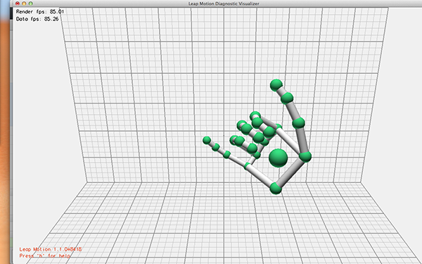

By modeling a human hand, the Leap Motion software can better predict the positions of fingers and hands that are not clearly in view. Five fingers are always present for a hand and hands can often cross over each other and still be tracked. Of course, the controller still needs to be able to see a finger or hand in order to accurately report its position. Keep this in mind when designing the interactions used by your application. Avoid requiring complex hand “poses” or subtle motions, especially those involving non-extended fingers.
https://di4564baj7skl.cloudfront.net/documentation/images/Visualizer_Hand_Model.png
Explore the behavior of the new hand model in the Diagnostic Visualizer
