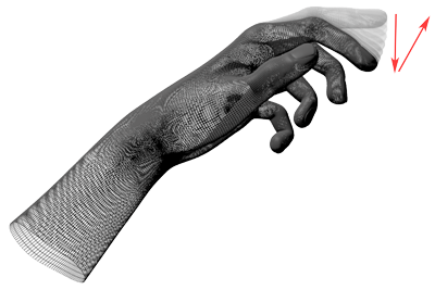

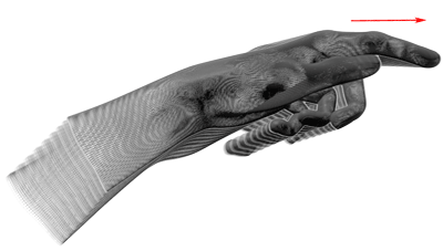

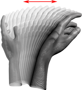

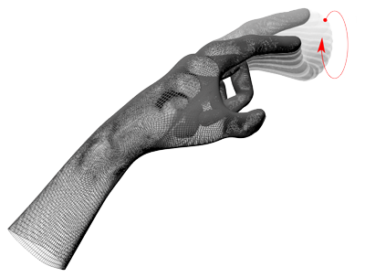

Gestures
The Leap Motion software recognizes certain movement patterns as gestures which could indicate a user intent or command. Gestures are observed for each finger or tool individually. The Leap Motion software reports gestures observed in a frame the in the same way that it reports other motion tracking data like fingers and hands.
Gestures are represented by the Gesture class and its subclasses, CircleGesture, KeyTapGesture, ScreenTapGesture, and SwipeGesture.
The following movement patterns are recognized by the Leap Motion software:
Circle — A finger tracing a circle.Swipe — A long, linear movement of a hand and its fingers.
Key Tap — A tapping movement by a finger as if tapping a keyboard key.Screen Tap — A tapping movement by the finger as if tapping a vertical computer screen.
Important: before using gestures in your application, you must enable recognition for each gesture you intend to use. The Controller class has an enableGesture() method that you can use to enable recognition for the types of gestures you use.
