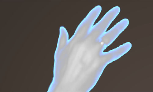

Image Hands ImageFullHand RiggedHand/Finger https://di4564baj7skl.cloudfront.net/documentation/images/unity/Unity_ImageHand.png

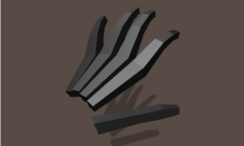

Procedural Hands PolyHand1/2/3, DebugHand PolyHand/Finger, DebugHand/Finger https://di4564baj7skl.cloudfront.net/documentation/images/unity/Unity_PolyHand.jpg

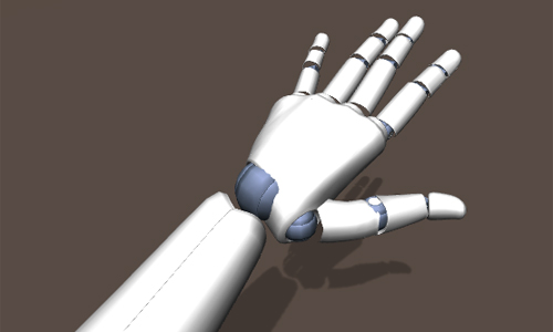

Component Hands MinimalHand, CleanRobotHand, GlowRobotHand SkeletalHand/Finger https://di4564baj7skl.cloudfront.net/documentation/images/unity/Unity_RobotHand.jpg

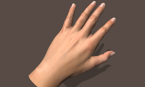

Rigged Hands All the human models RiggedHand/Finger https://di4564baj7skl.cloudfront.net/documentation/images/unity/Unity_SaltLightHand.jpg

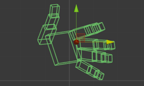

Physics Hands RigidHand, RigidFullHand, RigidRoundHand, ThickRigidHand RigidHand/Finger https://di4564baj7skl.cloudfront.net/documentation/images/unity/Unity_RigidHand.png

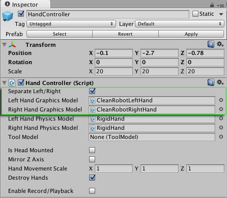

After adding a HandController to a scene, you can set the graphics model by dragging the desired hand prefab to the Hand Graphics Model slots.
https://di4564baj7skl.cloudfront.net/documentation/images/unity/Unity_HandControllerGraphics.png
If the Separate Left/Right setting is checked, you can use different prefabs for the right and left hands. Otherwise, the HandController mirrors a single model for both hands. The existing hand prefabs are all labeled “right” or “left” where it makes a difference (if you use the wrong hand model, the error will be obvious).
Change the size of the hands using the HandController Scale value. A scale of 1.0 is life-size, but that is often too small. It really depends on your scene. The edges of the default Unity cube, for example, are 1 meter long and would dwarf a life-size hand. Scaling the hands larger also increases their range of motion. You can further increase the range of motion without making the hands larger by increasing the HandController Hand Movement Scale values.
Setting the Is Head Mounted will provide a hint to the Leap Motion service that hands are viewed from the head-mounted position and improve hand recognition. The setting does not automatically rotate the hands in the game to appear in front of the HandController rather than above it. To do that, you can set the HandController rotation values to {x=270, y=180, z=0}.
