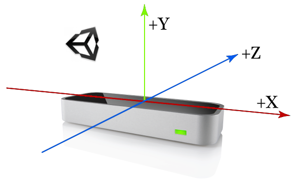

Coordinate Systems
Unity3D uses a left-handed convention for its coordinate system, wheras the Leap Motion API uses a right-handed convention. (Essentially, the z-axis points in the opposite direction.) Unity also uses a default unit of meters, wheras the Leap Motion API uses millimeters. The plugin scripts internally transforms the tracking data to use the left-handed coordinate system and scales distance values to meters.
https://di4564baj7skl.cloudfront.net/documentation/images/unity/Unity_Axes.png
The Unity left-handed coordinate system superimposed on the Leap Motion device in its desktop orientation.

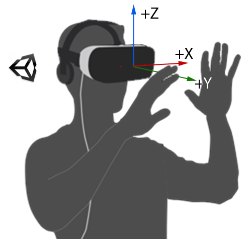

https://di4564baj7skl.cloudfront.net/documentation/images/unity/HMD_Unity_Axes.png
The Unity coordinate system superimposed on the Leap Motion device in its HMD orientation.
When you get tracking data directly from one of the classes in the Leap C# library, the data are in the native Leap coordinate system - not the Unity coordinate system. You can use the utility functions in the LeapUnityExtensions file to convert from Leap Motion coordinates to Unity coordinates. ToUnity() converts the axes from right-handed to left-handed and returns a Unity Vector3 object. ToUnityScaled() also scales the coordinates from milimeters to meters. ToUnity() is typically used with direction vectors; ``ToUnityScaled() with positions.

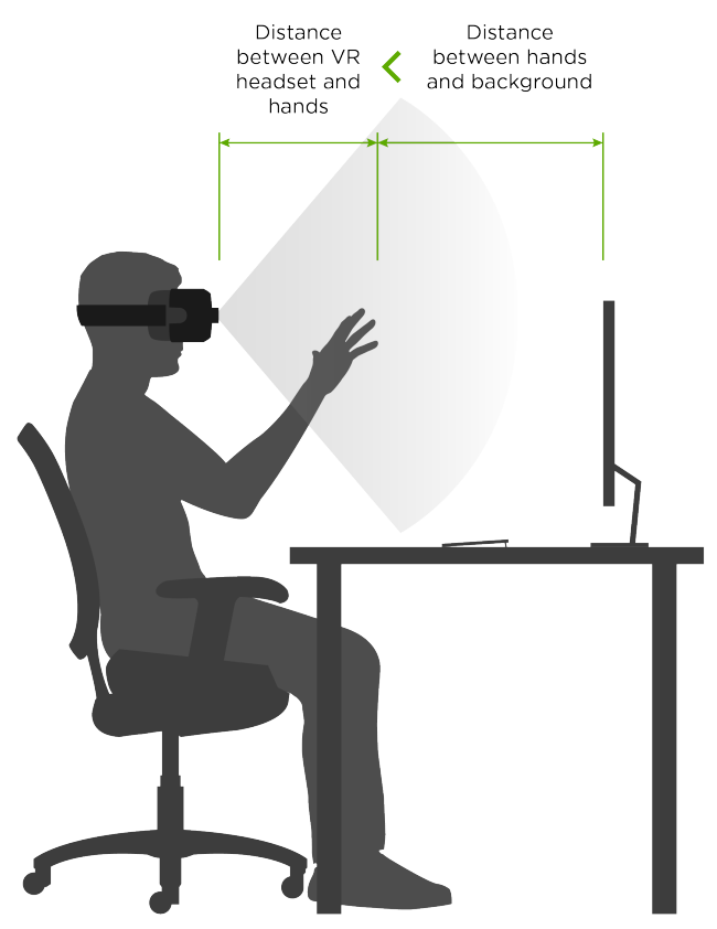

Detection and tracking work best when the controller has a clear, high-contrast view of an object’s silhouette. The Leap Motion software combines its sensor data with an internal model of the human hand to help cope with challenging tracking conditions.
https://di4564baj7skl.cloudfront.net/documentation/images/VR-distance.png
Particularly in HMD mode, you should ensure that there is less distance between the sensor and your hands then between your hands and any background objects or walls.
