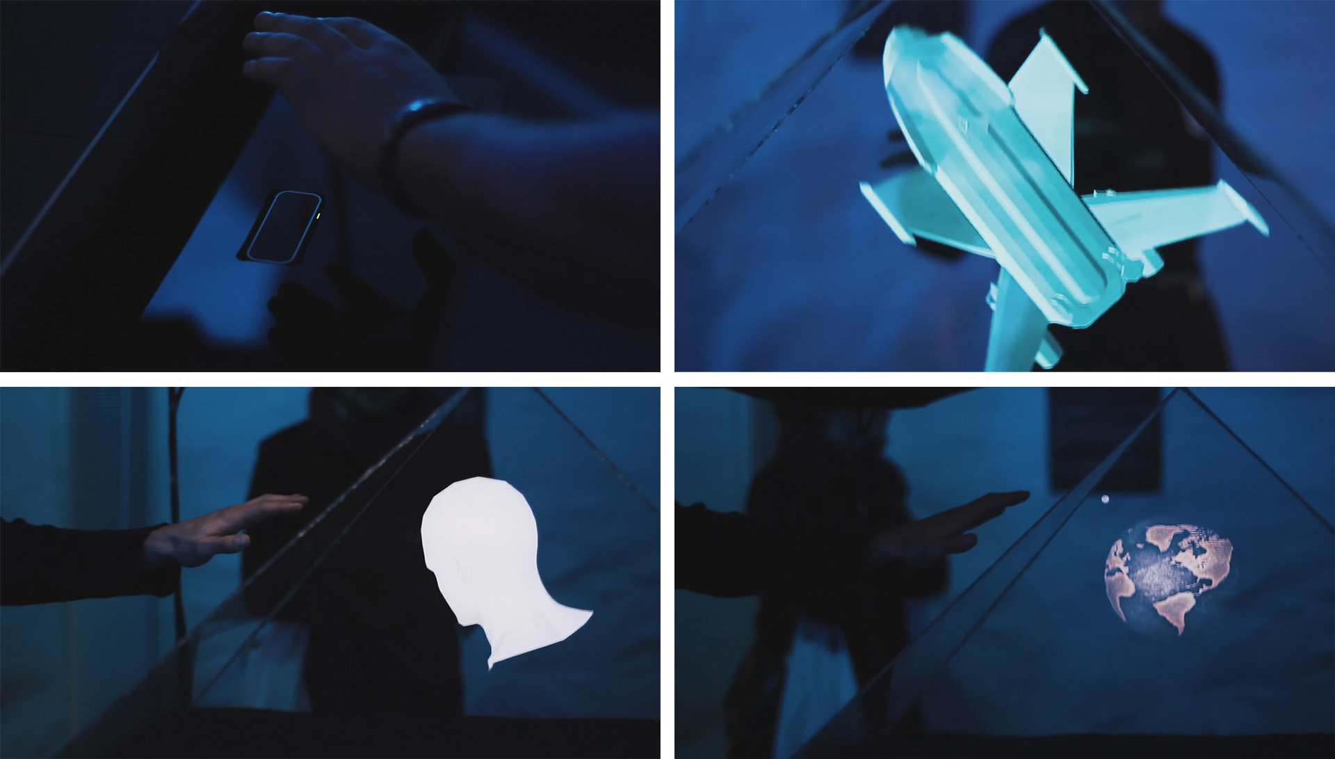

The medium: a plexiglass pyramid
Pepper’s ghost is a classic stage and magic trick that creates illusions by projecting images onto panes of glass – creating ghosts to haunt stage plays and theme park rides. Rather than using one screen for a reflection, the Hyper Island team decided to create a 3D hologram with a pyramid. Plexiglass was chosen for its clear and sharp reflective properties; plus its strength compared to glass allowed them to build a thin, large structure.
The light: a 55” LCD television
While the team originally considered using projectors, they soon discovered that this would require a complicated setup, and the light would be far too bright without a filter or redirection. “Using a TV screen allowed us to keep the four different reflections in sync, and ensure the hologram was sharp,” says Ellinor Pettersson, one of the showpiece’s creators.
“We could also change the brightness of the screen, and by using a black background with the perfect brightness we could make it look as if the object was just hovering freely inside the pyramid.”
The illusion: WebGL
Originally, the models created for Calderan were designed in a 3D CAD program. However, the team quickly found that the fully rendered 3D model wouldn’t allow for real-time manipulation. Any lag would instantly shatter the illusion. By placing the model into WebGL, they were able to create different viewpoints on four sides of the model – so that the Leap Motion interaction would change the viewpoints rather than the object itself.
