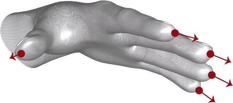

- (LeapVector *) direction
direction
The direction in which this finger or tool is pointing.
LeapVector *direction = pointable.direction;
The direction is expressed as a unit vector pointing in the same direction as the tip.
https://di4564baj7skl.cloudfront.net/documentation/images/Leap_Finger_Model.png
Return
The LeapVector pointing in the same direction as the tip of this LeapPointable object.
Since 1.0
