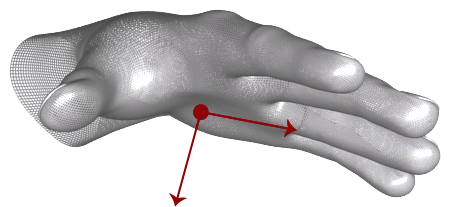

- (LeapMatrix *) basis
basis
The orientation of the hand as a basis matrix.
The basis is defined as follows:
xAxis Positive in the direction of the pinky
yAxis Positive above the hand
zAxis Positive in the direction of the wrist
Note: Since the left hand is a mirror of the right hand, the basis matrix uses the left-hand rule for left hands.
LeapFrame *frame = [leap frame:0];
for (LeapHand *hand in [frame hands]) {
    LeapMatrix *handTransform = [[LeapMatrix alloc] initWithXBasis:hand.basis.xBasis
                                                            yBasis:hand.basis.yBasis
                                                            zBasis:hand.basis.zBasis
                                                            origin:hand.basis.origin];
    handTransform = [handTransform rigidInverse];
    LeapInteractionBox *iBox = frame.interactionBox;
    for (LeapFinger *finger in hand.fingers)
        LeapVector *transformedPosition = [handTransform transformPoint:finger.tipPosition];
        LeapVector *transformedDirection = [handTransform transformDirection:finger.direction];
Return
The basis of the hand as a matrix.
Since
2.0

- (LeapVector *) direction
direction
The direction from the palm position toward the fingers.
LeapVector *direction = hand.direction;
The direction is expressed as a unit vector pointing in the same direction as the directed line from the palm position to the fingers.
Return
The LeapVector pointing from the palm position toward the fingers.
Since 1.0

- (LeapVector *) palmNormal
palmNormal
The normal vector to the palm.
If your hand is flat, this vector will point downward, or “out” of the front surface of your palm.
https://di4564baj7skl.cloudfront.net/documentation/images/Leap_Palm_Vectors.png
The direction is expressed as a unit vector pointing in the same direction as the palm normal (that is, a vector orthogonal to the palm).
LeapVector *normal = hand.palmNormal;
Return
The LeapVector normal to the plane formed by the palm.
