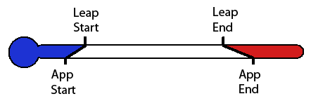

Mapping coordinates is much like converting temperatures from celsius to fahrenheit if you imagine each axis as a scale with corresponding start (freezing) and an end (boiling) points:
https://di4564baj7skl.cloudfront.net/documentation/images/CoordinateThermometer.png
You can use this formula to make the conversion:
\[x_{app} = (x_{leap} - Leap_{start})\frac{Leap_{range}}{App_{range}} + App_{start}\]
where:
\[Leap_{range} = Leap_{end} - Leap_{start}\]\[App_{range} = App_{end} - App_{start}\]

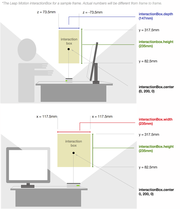

The LeapInteractionBox defines a rectilinear area within the Leap Motion field of view.
https://di4564baj7skl.cloudfront.net/documentation/images/Leap_InteractionBox.png
As long as the user’s hand or finger stays within this box, it is guaranteed to remain in the Leap Motion field of view. You can use this guarantee in your application by mapping the interaction area of your application to the area defined by the InteractionBox instead of mapping to the entire Leap Motion field of view. The LeapInteractionBox class provides the normalizePoint:clamp: method to help map Leap Motion coordinates to your application coordinates (by first normalizing them to the range [0..1]).
https://di4564baj7skl.cloudfront.net/documentation/images/IBox_Diagram.png
The size of the LeapInteractionBox is determined by the Leap Motion field of view and the user’s interaction height setting (in the Leap Motion control panel). The controller software adjusts the size of the box based on the height to keep the bottom corners within the filed of view. If you set the interaction height higher, then the box becomes larger. Users can set the interaction height based on the height they prefer to hold their hands when using the controller. Some users like to hold their hands much higher above the device than others. By using the InteractionBox to map the Leap Motion coordinate system to your application coordinate system, you can accommodate both types of user. A user can also set the interaction height to adjust automatically. If the user moves his or her hands below the current floor of the interaction box, the controller software lowers the height (until it reaches the minimum height); likewise if the user moves above the interaction box, the controller raises the box.
Because the interaction box can change size and position, every LeapFrame object contains an instance of the LeapInteractionBox class. The following example illustrates the behavior of the interaction box. Change your interaction height settings using the Leap Motion control panel to see how it affects the box itself.
Box width = ...
Box height = ...
Box depth = ...
Box center = ...
Box origin = ...

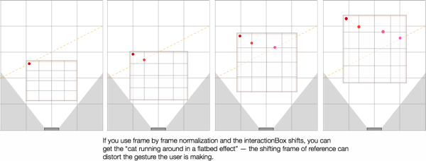

Because the interaction box can change over time, be aware that the normalized coordinates of a point measured in one frame may not match the normalized coordinates of the same real world point, when normalized using the interaction box provided by another frame. Thus straight lines or perfect circles “drawn in the air” by the user may not be straight or smooth if they are normalized across frames. For most applications, this isn’t a significant problem, but you should test your application with the Automatic Interaction Height setting enabled if you aren’t sure.
https://di4564baj7skl.cloudfront.net/documentation/images/IBox_FOR.png
To guarantee that a set of points tracked across frames is normalized consistently, you can save a single InteractionBox object - ideally the one with the largest height, width, and depth - and use that to normalize all the points.
