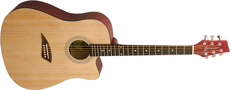

We can think of any instrument as having an input and an output – an interface for a musician to interact with, and a sound generator that forms the music people hear. In the case of an acoustic guitar like the one above, the strings themselves are both the interface and the sound generator. This means that the mapping between both input and output is dictated by the laws of physics – it’s deterministic, richly packed with subtleties at many levels, yet predictable and immutable. The same is true for all acoustic instruments.
