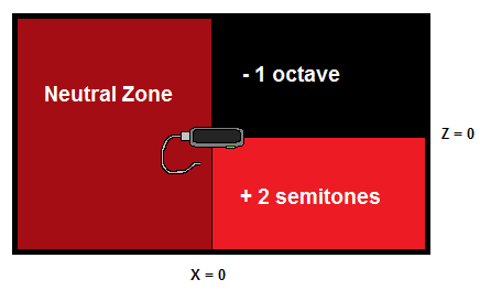

With the X axis, I wanted to shift the guitar’s pitch, like when bending a string. This was the most exciting feature for me. Some people say that no two guitarists bend strings exactly alike – it’s an action full of subtleties and it yields a lot of expressiveness. Since the X axis is the dimension along which I can move with the most control, this modulation is well deserving of VIP treatment. I even sometimes find myself naturally turning forward a little bit when bending a string, so this mapping even matches my natural movements. In theory, it was a perfect fit!
But there was a problem. During a song, you only occasionally want to slide through intermediate notes. Most of the time, you want to be playing proper notes that are well in tune. As it’s near-impossible to keep the guitar perfectly rigid in the X dimension while playing, I was inevitably detuning all over the place. The solution I found was splitting the sensing area into two halves and only bending the pitch past a given threshold – where X = 0. You can see how this works in the diagram below, or see it live.
On the left side of that threshold, I created a neutral area where the pitch bending amount is always 0. I later pushed things a bit further and assigned two different modalities for changing the pitch – raise it up two semitones (like when you bend a string) and lowering it down a whole octave. To make both options available in the same space, I split the area past the X = 0 threshold ( the pitch-bending area) into two along the Z = 0 line, sending two different mutually exclusive MIDI messages – one sliding pitch up two semitones and the other sliding pitch down an octave.
