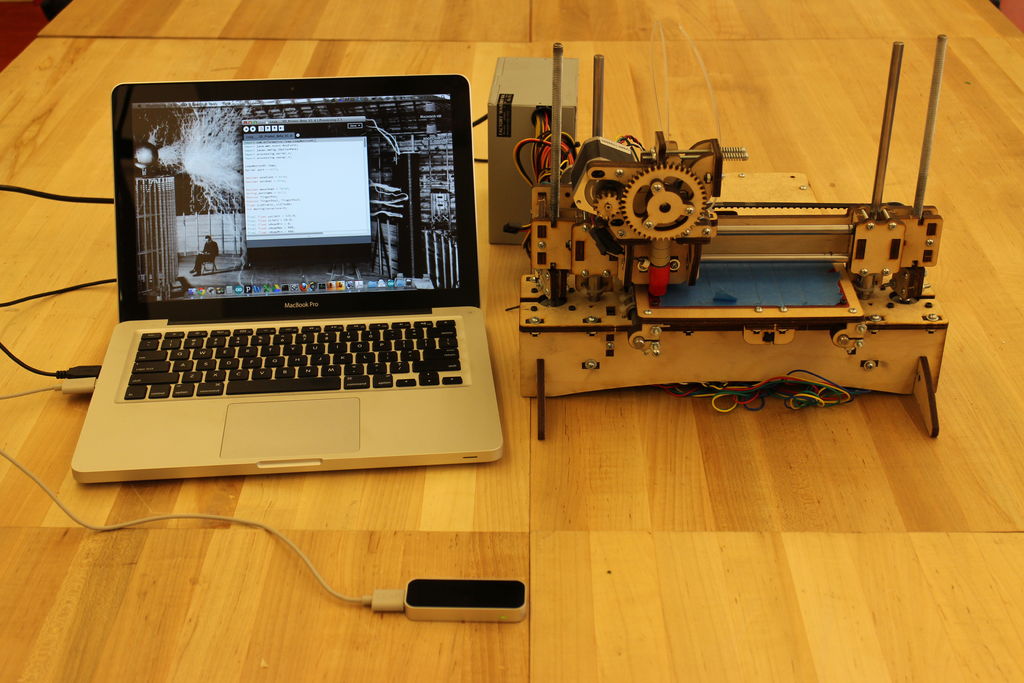

The setup for this project is a Leap Motion Controller, a 3D printer with an Arduino-based controller (newer Makerbots won’t work without some tinkering), and the program is run with Processing. In order to use the Leap Motion device with Processing, you need to install this library.
The Processing sketch is gathering the Cartesian coordinates (X, Y, and Z) of your fingers read by the Leap Motion Controller. It takes these values and converts it into the Cartesian coordinates needed for the 3D printer, packages it into G-code format, and sends it over the printer.

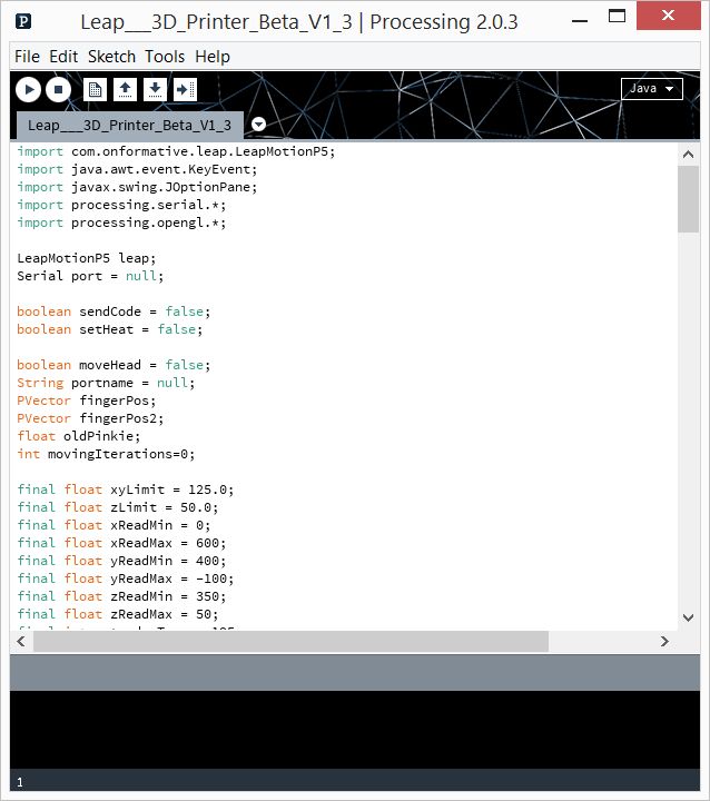

Step 4: Overview of the Processing sketch
You can download the Processing sketch here.
There are a few things to point out and modify if needed.
xyLimit & zLimit are the maximum distances that can be moved on these axes. These values are in millimeters.
xReadMin, yReadMax, etc. are setting the range that is being read by the Leap Motion Controller. The device can read larger than these areas but I wanted to confine it into a smaller area. It also seemed like the Leap Motion Controller would be less consistent the further away from the device you are. But maybe I made that up. I don’t remember anymore.
There is some code that I borrowed that asks you what serial port you want to connect to when you first run the program. It’s a little annoying because you need to set it each time you run the program but far less annoying than any other method I’ve used (especially when it doesn’t work).
