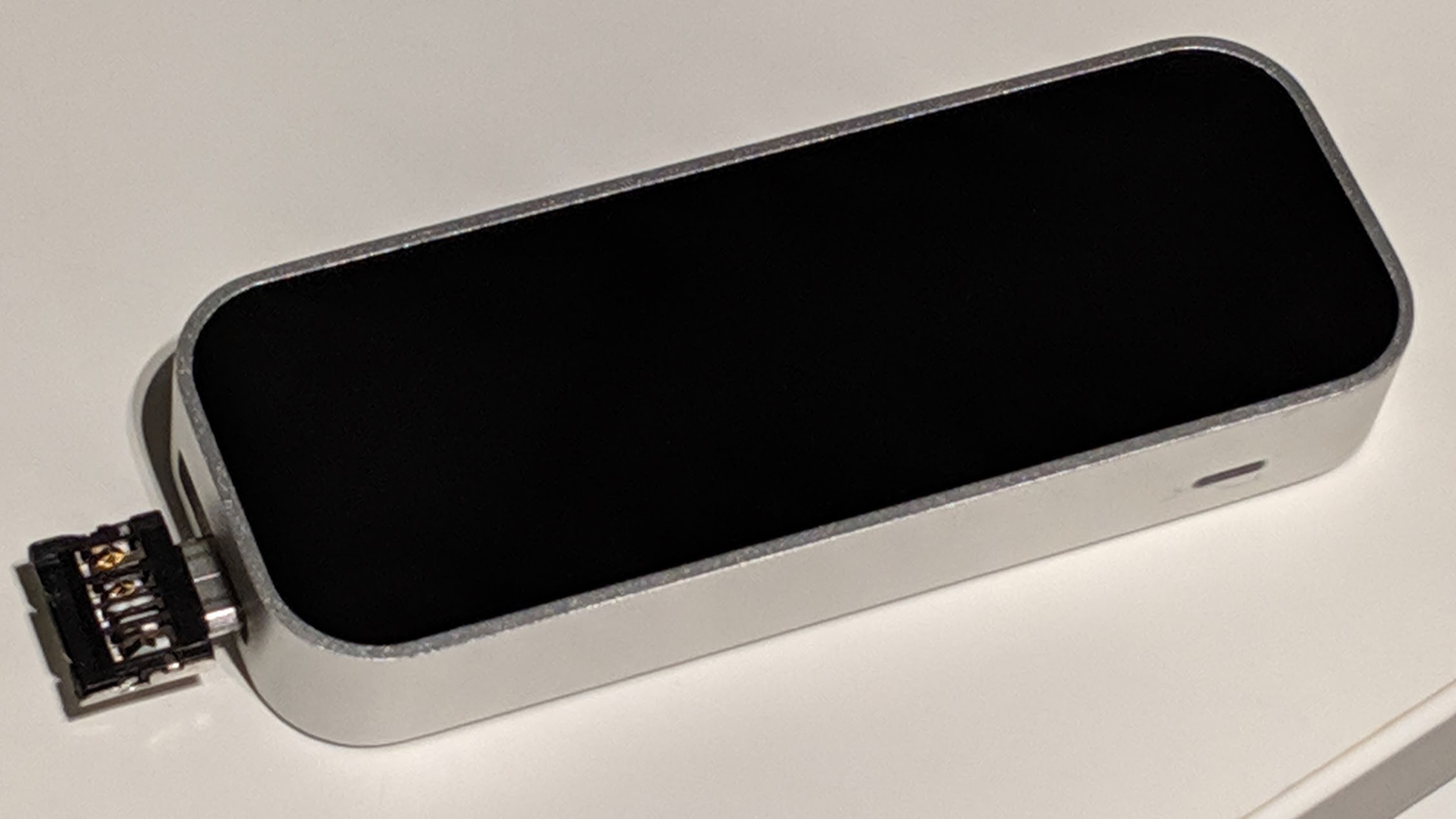

Can I plug the Leap Motion Controller directly into the Valve Index?
Our developer community has found that a tiny micro USB to USB A adaptor will make this possible:
You can stick the micro end into the Leap Motion Controller (see this photo) and plug it in to the larger of the two ports on the side. You should experience a framerate of 115 fps. Note that according to the developer who tried it, “the tracking is a lot worse if you put the frunk cover on over it. The plastic is too reflective, causing glare from the Leap Motion's infrared LEDs.”
