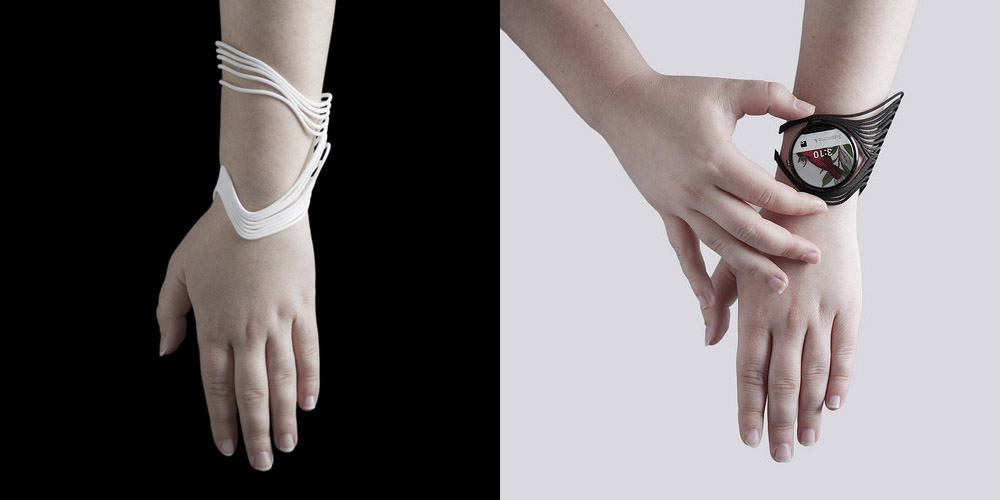

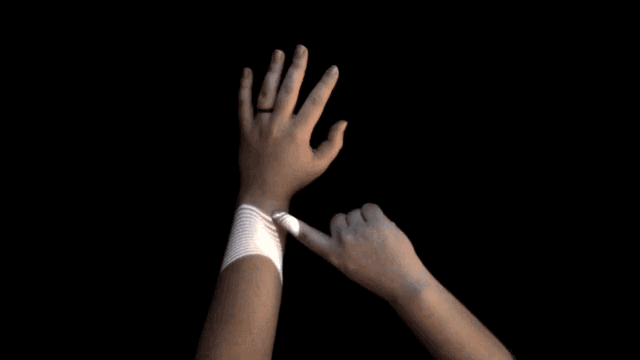

TACTUM is an augmented modeling tool that lets you design 3D printed wearables directly on your body. It uses depth sensing and projection mapping to detect and display touch gestures on the skin. A person can simply touch, poke, rub, or pinch the geometry projected onto their arm to customize ready-to-print, ready-to-wear forms.

Using its skeletal tracking capabilities, we were able to dynamically project digital content onto a moving arm, and we used it as a touch sensor to detect and track tactile interactions with the body. The goal of TACTUM was to create a gestural modeling tool that did not rely on mid-air interactions. Instead, we used the controller to detect how a person is touching, pinching, or poking their arm, and we use these gestures to modify interactive geometry in our modeling environment.

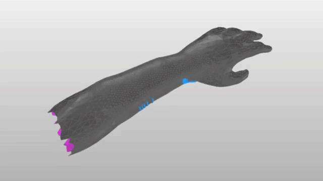

We used the Leap Motion Java API to create our skeletal tracking and touch gesture detection, we used Processing and the Toxiclibs library to create our modeling environment and interactive geometry, and we used OpenCV to calibrate our projection mapping.
