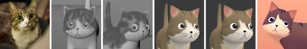

Cat Explorer is an experiment in spatial interaction design that focuses on using hands to explore the structural layout of a relatively complex object – in this case a loose anatomical model of a cat named Whiskey.
Modeling of cat and internal organs by Pablo Lopéz, based on Keiichi’s cat Donna.
