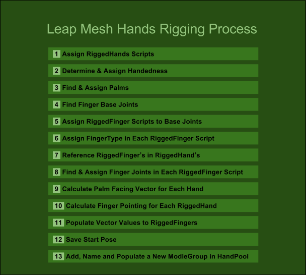

The new LeapHandAutorig Monobehavior script acts as a quarterback for an array of scripts and methods which comprise the rigged hands setup process. Sitting at the top of a hands hierarchy, the script runs in the editor. The Autorig button in the Inspector sets off a chain of actions that works through the steps outlined in the chart below.
After autorigging, the LeapHands Autorig Inspector console acts as a central control panel to push values to the other Leap Motion rigging scripts. This allows you to test the model quickly and set certain values centrally, instead of digging through the hierarchy to set values in all the scripts manually.
Autorigging can act on a variety of FBX assets, and works in two different ways, depending on whether the asset has a Unity Mecanim Humanoid definition. If so, then LeapHandsAutorig finds and assign joints based on this mapping. If not, then LeapHandsAutorig searches the hierarchy below its Transform by a list of names typical of common character rigging practices.
