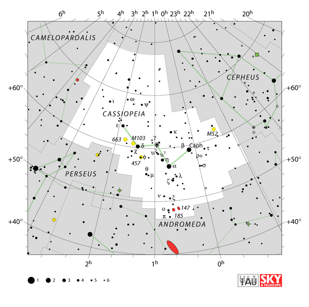

The other major set of data we wanted to show was the constellations that make up the night sky. This is where we run into some vaguery. When most people hear the word constellation, they think of the illustrated lines connecting stars to form figures in the night sky, like Orion the Hunter, Cassiopeia the Queen, Sagittarius the Archer, and Scorpius the Scorpion. In the scientific community, a constellation is actually a region of the night sky. Every star in that region of the sky is a part of that constellation. The International Astronomical Union (IAU) officially recognizes 88 constellations covering the entire night sky. Their borders are well-defined and generally agreed upon.
What’s not agreed upon are the lines that define a constellation’s “asterism” – the figure made up by connecting some of the stars in the constellation. Asterisms also aren’t always associated with one of the 88 constellations. The Big Dipper is an asterism, but its stars are all within the constellation Ursa Major, which also has an associated asterism of the same name. The general shapes of the standard 88 figures are mostly consistent, but look at three different star charts and you’ll probably find three different sets of lines making up the asterisms.
Ultimately, this meant there wasn’t a nice clean database of asterism lines I could simply parse and import into the planetarium. In the end, I studied a number of different star charts and hand-entered all the asterisms into a spreadsheet, which I rigged up to export into a CSV format I could easily parse. (If you’re interested in the data, you’re welcome to dig into the spreadsheet. All the stars are referenced by their Henry Draper Catalogue ID.)
