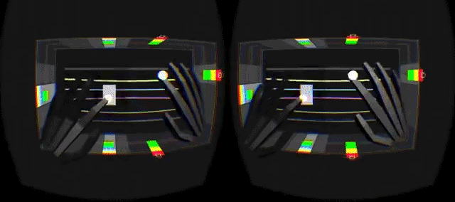

Stage 3: Additional Depth Cues for VR
When it comes to visual indicators in VR, there’s a delicate balance between being distracting and being easy to overlook. In the third video, Zach has added a few new types of visual indicators that hit this crucial balance.
Are you concerned that visual indicators on the edge of the screen risk causing distraction in the periphery of your vision?
I see it the other way – placing them at the edges of vision helps avoid distraction. My first attempt at a depth indicator (in the second video) placed graphics on the front and back sides of the “strum zone.” This worked well for slow, deliberate tests, but not as well in an actual guitar-playing scenario. The indicators were too subtle to see clearly when moving quickly, and making them brighter or bolder meant more clutter in front of the strings and selectors.
You made several “layers” of indicators in this update video. Red/yellow/green ones to show depth and whether the hands are in the “strum” space. White highlight blocks to help show you where your chord hand was in space. And light grey blocks to show on the sides where the strings lined up.
That’s a somewhat complicated combo, yet it seems to work beautifully. What was your thought process here?
Thanks! So far, I agree – I think I’m on the right track with this latest concept. Wrapping the visual indicators around the “strum zone” allows them to be easier to see – or maybe, easier to perceive – without obstructing your view of the main interactions.
My goal is for the user to be aware of these visual indicators, and find them helpful, without really paying attention to them. For example, you might be focused on your chord selections, but with the flash of red near the edge of your vision, you immediately know when, and where, you have moved outside the “strum zone”.
Of course, the design of these indicators is still in an early phase. As I refine them, I anticipate that certain colors or shapes or sizes will be more effective than others, and that each “layer” will retain distinct visual cues. All of these elements need to be balanced properly to make this “complicated combo” work well.
