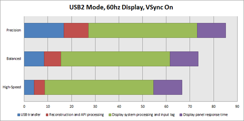

Latency in USB2 Mode, 60hz Display, VSync On
This is incredibly frustrating to us here at Leap Motion, since the vast majority of the perceived latency is outside of our control. However, let’s see what happens as we disable vertical synchronization:

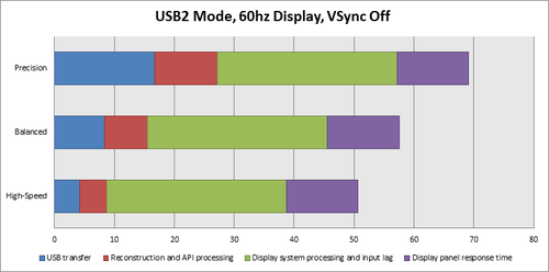

Latency in USB2 Mode, 60hz Display, VSync Off
Disabling VSync saves anywhere from 16ms to over 30ms, depending on the particular graphics system. However, the downside to disabling VSync is the presence of screen tearing, as we discussed in part one.

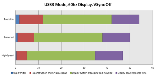

If you happen to have a USB3 cable and port, we showed how this can dramatically reduce data transfer time between the device and your computer. Here’s how that reduction compares to the other sources of latency:
Latency in USB3 Mode, 60hz Display, VSync Off
In this setup under High-Speed mode our hardware and software together only contribute a little over 10% of the overall perceived latency. (Did I mention we were frustrated?)

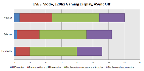

High-performance “gaming” monitors are fairly common these days, offering reduced input lag and panel response time. Let’s take a look at the numbers of the best overall configuration:
Latency in USB3 Mode, 120hz Gaming Display, VSync Off
For the first time, in High-Speed mode, we’ve crossed below our 30-millisecond threshold mentioned earlier. The hope is that as time passes, you won’t need to jump through as many hoops to achieve that level of responsiveness, and instead it will be taken for granted.
