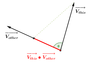

- (float) dot:(const LeapVector *) vector
The dot product of this vector with another vector.
float dotProduct = [thisVector dot:thatVector];
The dot product is the magnitude of the projection of this vector onto the specified vector.
https://di4564baj7skl.cloudfront.net/documentation/images/Math_Dot.png
Return
The dot product of this vector and the specified vector.
Since 1.0

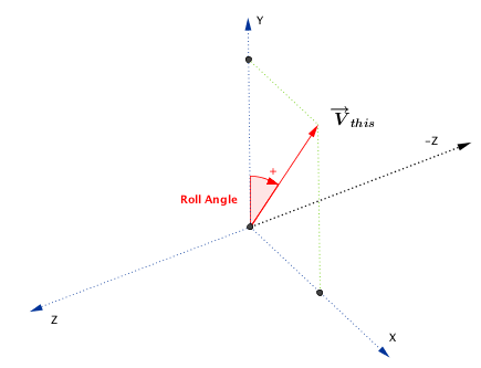

- (float) roll
roll
The roll angle in radians.
float rollInRadians = thatVector.roll;
Roll is the angle between the y-axis and the projection of the vector onto the x-y plane. In other words, roll represents rotation around the z-axis. If the vector points to the left of the y-axis, then the returned angle is between 0 and pi radians (180 degrees); if it points to the right, the angle is between 0 and -pi radians.
https://di4564baj7skl.cloudfront.net/documentation/images/Math_Roll_Angle.png
Use this function to get roll angle of the plane to which this vector is a normal. For example, if this vector represents the normal to the palm, then this function returns the tilt or roll of the palm plane compared to the horizontal (x-z) plane.
Return
The angle of this vector to the right or left of the y-axis.
Since 1.0
