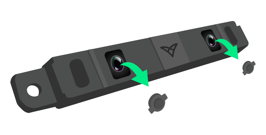

For Stereo IR 170
If you have an Ultraleap Stereo IR 170 and access to a 3D printer, we recommend downloading and printing the free Stereo IR 170 Mount (CAD files).
If using the 3D printed mount, attach to the centre of the headset and insert the Stereo IR 170. Otherwise, we recommend using a small strip of velcro in the same position.
The Stereo IR 170 operates with a typical horizontal and vertical field of view of 170° x 170° and a depth of reliable tracking of 10cm to 75cm.
Remove both lens caps from the Stereo IR 170
Stereo IR 170 lens caps

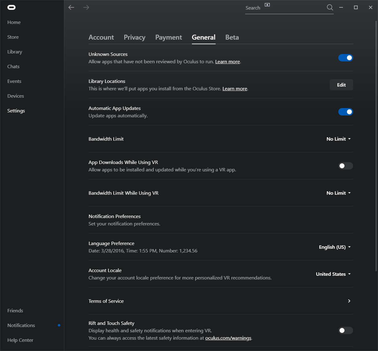

2. If using an Oculus headset, enable external apps
⚠️ If using an Oculus VR headset, you must enable it to run applications outside of Oculus Home.
From the Oculus App Settings, check Unknown sources.
oculus external apps
