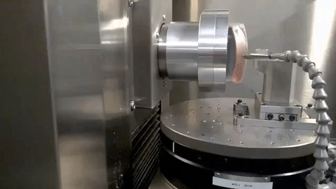

The next step was to carve a pair of prototype reflectors from a solid block of optical-grade acrylic. The reflectors needed to possess a smooth, precise surface (accurate to a fraction of a wavelength of light) in order to reflect a clear image while also being optically transparent. Manufacturing optics with this level of precision requires expensive tooling, so we “turned” to diamond turning (the process of rotating an optic on a vibration-controlled lathe with a diamond-tipped tool-piece).
Soon we had our first reflectors, which we coated with a thin layer of silver (like a mirror) to make them reflect 50% of light and transmit 50% of light. Due to the logarithmic sensitivity of the eye, this feels very clear while still reflecting significant light from the displays.

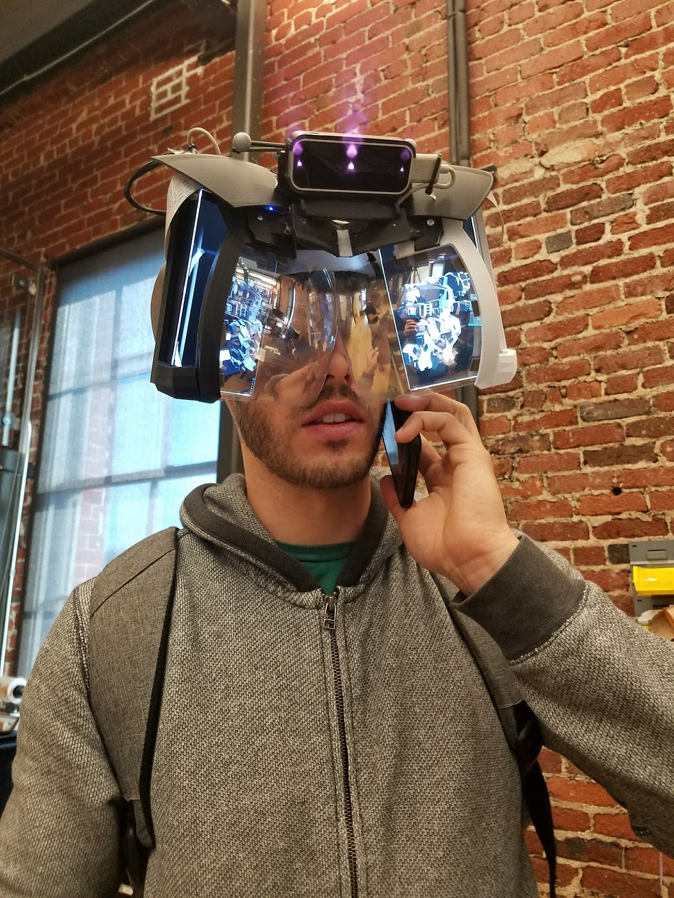

While it might seem a bit funny, it was perhaps the widest field of view, and the highest-resolution AR system ever made. Each eye saw digital content approximately 105° high by 75° wide with a 60% stereo overlap, for a combined field of view of 105° by 105° with 1440×2560 resolution per eye.
The vertical field of view struck us most of all; we could now look down with our eyes, put our hands at our chests and still see augmented information overlaid on top of our hands. This was not the minimal functionality required for a compelling experience, this was luxury.

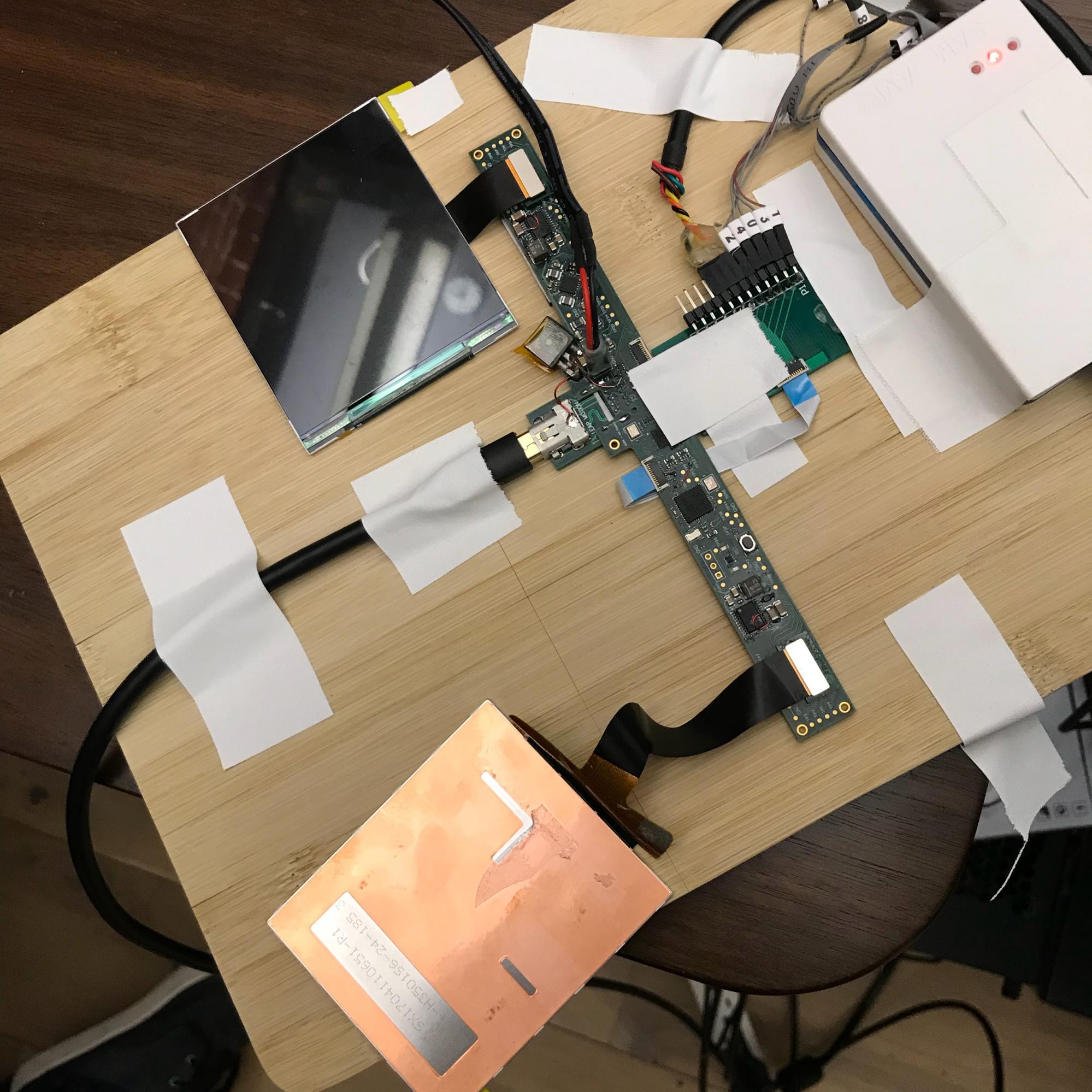

The second thing that struck us during this testing process was just how important the framerate of the system is. The original headset boasted an unfortunate 50 fps, creating a constant and impossible to ignore slosh in the experience. With the smaller reflectors, we could move to smaller display panels with higher refresh rates.
At this point, we needed to make our own LCD display system (nothing off the shelf goes fast enough). We settled on a system architecture that combines an Analogix display driver with two fast-switching 3.5″ LCDs from BOE Displays.
Put together, we now had a system that felt remarkably smaller:
The reduced weight and size feel exponential. Every time we cut away one centimeter, it felt like we cut off three.
We ended up with something roughly the size of a virtual reality headset. In whole it has fewer parts and preserves most of our natural field of view. The combination of the open air design and the transparency generally made it feel immediately more comfortable than virtual reality systems (which was actually a bit surprising to everyone who used it).

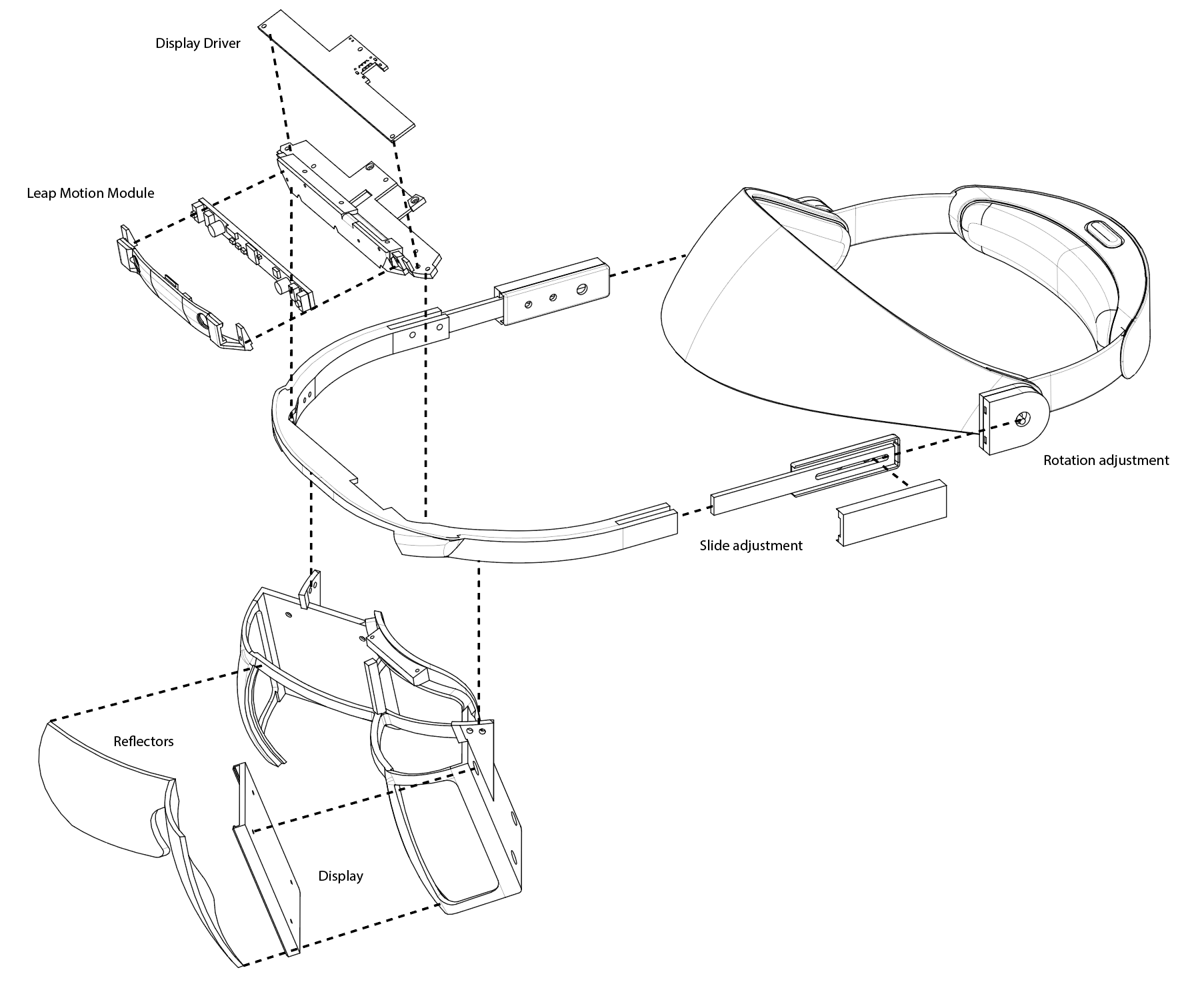

We mounted everything on the bottom of a pivoting ‘halo’ that let you flip it up like a visor and move it in and out from your face (depending on whether you had glasses).
Sliding the reflectors slightly out from your face gave room for a wearable camera, which we threw together created from a disassembled Logitech (wide FoV) webcam.
All of the videos you’ve seen were recorded with a combination of these glasses and the headset above.
Last we want to do one more revision on the design to have room for enclosed sensors and electronics, better cable management, cleaner ergonomics and better curves (why not?) and support for off the shelf head-gear mounting systems. This is the design we are planning to open source next week.

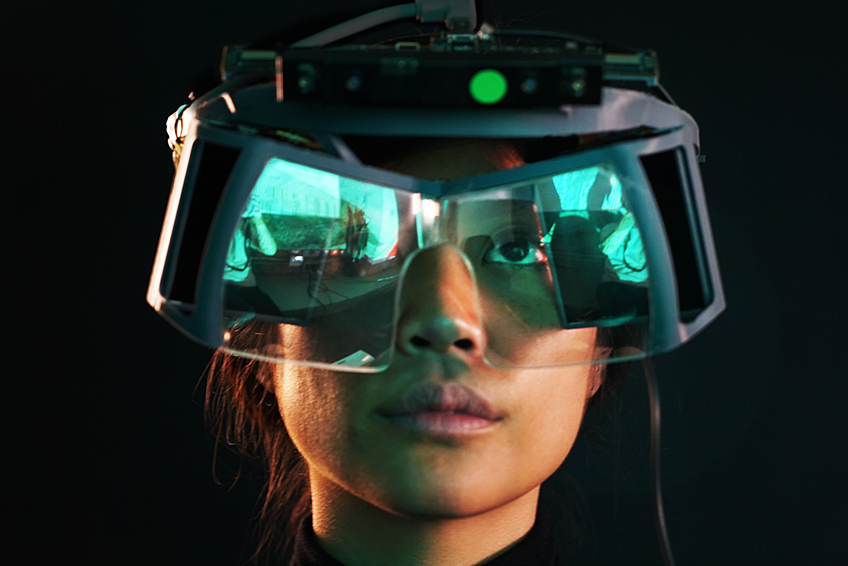

However, on the whole, what you see here is an augmented reality system with two 120 fps, 1600×1440 displays with a field of view covering over a hundred degrees combined, coupled with hand tracking running at 150 fps over a 180°x 180° field of view. Putting this headset on, the resolution, latency, and field of view limitations of today’s systems melt away and you’re suddenly confronted with the question that lies at the heart of this endeavor:
What shall we build?
