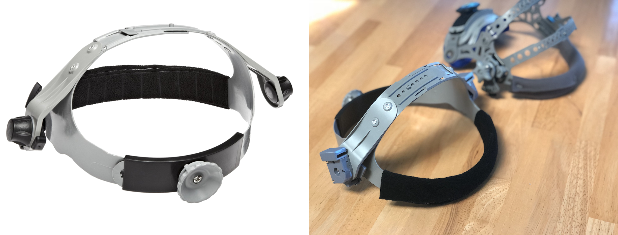

Alternate Headgear Option
When we first started developing North Star prototypes, we used 3M’s Speedglas Utility headgear. At the time, the optics would bounce around, causing the reflected image to shake wildly as we moved our heads. We minimized this by switching to the stiffer Miller headgear and continued other improvements for several months.
However, the 3M headgear was sorely missed, as it was simple to put on and less intimidating for demos. Since then we added cheek alignment features, which solved the image bounce. As a result we’ve brought back the earlier design as a supplement to the release headgear. The headgear and optics are interchangeable – only the hinges need to match the headgear. Hopefully this enables more choices in building North Star prototypes.

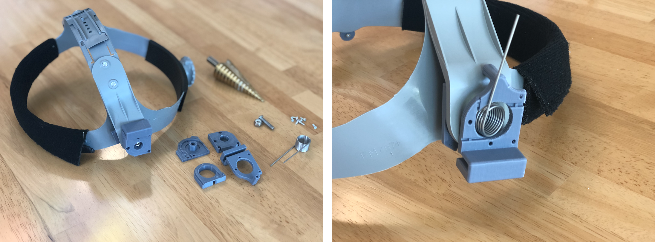

Torsion Spring Hinges
One of the best features of the old headgear was torsion hinges, which we’ve introduced with the latest release. Torsion hinges lighten the clamping load needed to keep the optics from pressing on users’ faces. (Think of a heavy VR HMD – the weight resting on the nose becomes uncomfortable quickly.)
Two torsion springs constantly apply twisting force on the aluminum legs, fighting gravity acting on the optics. The end result is the user can acutely suspend the optics above the nose, and even completely flip up the optics with little effort. After dusting off the original hinge prototypes, rotation limits and other simple modifications were made (e.g. using the same screws as the rest of the assembly). Check out the build guide for details.
