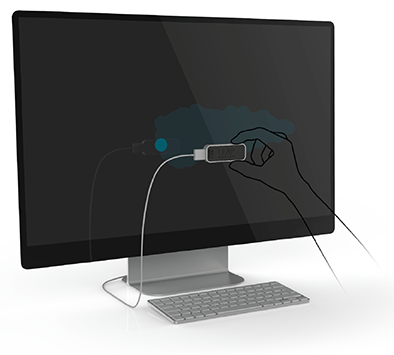

To recalibrate your Leap Motion Controller:
  1. Open the Leap Motion Settins application using the icon menu on the Windows Taskbar or Mac Finder bar.
  2. Select the Troubleshooting page.
  3. Click the Recalibrate Device button.
  4. Follow the on-screen instructions to perform the calibration procedure.
../Common/images/Leap_Recalibrate.png
You will need a flat, reflective surface. A mirror is ideal, but many other reflective surfaces like a flat screen monitor will work accetably as well. During the procedure, hold the Leap Motion Controller so that the LEDs shine on the reflective surface and are reflected back into the top of the device. The calibration window displays a disk that moves as you change the angle between the surface and the device. Rotate the controller to move this disc so that it "paints" the window. Moving the Leap Motion Controller up and down or side to side does not adversely affect the calibration, but calibration requires rotation.
