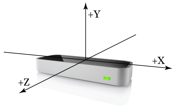

Coordinate system
The Leap Motion system employs a right-handed Cartesian coordinate system. Values reported are in units of real-world millimeters. The origin is centered at the center of the Leap Motion Controller. The x- and z-axes lie in the horizontal plane, with the x-axis running parallel to the long edge of the device. The y-axis is vertical, with positive values increasing upwards (in contrast to the downward orientation of most computer graphics coordinate systems). The z-axis has positive values increasing away from the computer screen.
../../../Common/images/Leap_Axes.png
The Leap Motion right-handed coordinate system.
