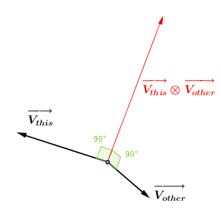

Vector com.leapmotion.leap.Vector.cross ( Vector other )
The cross product of this vector and the specified vector.
The cross product is a vector orthogonal to both original vectors. It has a magnitude equal to the area of a parallelogram having the two vectors as sides. The direction of the returned vector is determined by the right-hand rule. Thus A.cross(B) == -B.cross(A).
Vector crossProduct = thisVector.cross(thatVector);
Parameters
other A Vector object.
Returns
Since
1.0

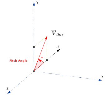

float com.leapmotion.leap.Vector.pitch ( )
The pitch angle in radians.
Pitch is the angle between the negative z-axis and the projection of the vector onto the y-z plane. In other words, pitch represents rotation around the x-axis. If the vector points upward, the returned angle is between 0 and pi radians (180 degrees); if it points downward, the angle is between 0 and -pi radians.
float pitchInRadians = thisVector.pitch();
Returns
The angle of this vector above or below the horizon (x-z plane).
Since
1.0

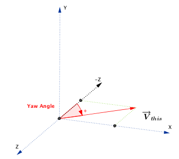

float com.leapmotion.leap.Vector.yaw ( )
The yaw angle in radians.
Yaw is the angle between the negative z-axis and the projection of the vector onto the x-z plane. In other words, yaw represents rotation around the y-axis. If the vector points to the right of the negative z-axis, then the returned angle is between 0 and pi radians (180 degrees); if it points to the left, the angle is between 0 and -pi radians.
float yawInRadians = thisVector.yaw();
Returns
The angle of this vector to the right or left of the negative z-axis.
