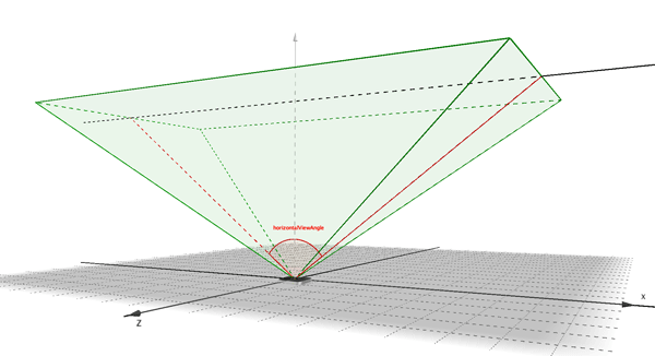

float com.leapmotion.leap.Device.horizontalViewAngle ( )
The angle of view along the x axis of this device.
The Leap Motion controller scans a region in the shape of an inverted pyramid centered at the device's center and extending upwards. The horizontalViewAngle reports the view angle along the long dimension of the device.
float angleOnLongDimension = device.horizontalViewAngle();

float com.leapmotion.leap.Device.verticalViewAngle ( )
The angle of view along the z axis of this device.
The Leap Motion controller scans a region in the shape of an inverted pyramid centered at the device's center and extending upwards. The verticalViewAngle reports the view angle along the short dimension of the device.
float angleOnShortDimension = device.verticalViewAngle();
