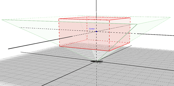

Detailed Description
The InteractionBox class represents a box-shaped region completely within the field of view of the Leap Motion controller.
The interaction box is an axis-aligned rectangular prism and provides normalized coordinates for hands, fingers, and tools within this box. The InteractionBox class can make it easier to map positions in the Leap Motion coordinate system to 2D or 3D coordinate systems used for application drawing.
The InteractionBox region is defined by a center and dimensions along the x, y, and z axes.
