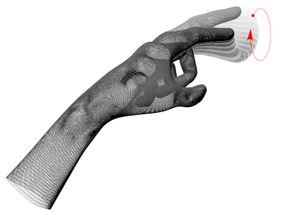

Detailed Description
The CircleGesture classes represents a circular finger movement.
A circle movement is recognized when the tip of a finger draws a circle within the Leap Motion Controller field of view.
Important: To use circle gestures in your application, you must enable recognition of the circle gesture. You can enable recognition with:
controller.enableGesture(Gesture.Type.TYPE_CIRCLE);
Circle gestures are continuous. The CircleGesture objects for the gesture have three possible states:
You can set the minimum radius and minimum arc length required for a movement to be recognized as a circle using the config attribute of a connected Controller object. Use the following keys to configure circle recognition:
