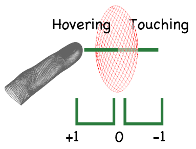

float com.leapmotion.leap.Pointable.touchDistance ( )
A value proportional to the distance between this Pointable object and the adaptive touch plane.
The touch distance is a value in the range [-1, 1]. The value 1.0 indicates the Pointable is at the far edge of the hovering zone. The value 0 indicates the Pointable is just entering the touching zone. A value of -1.0 indicates the Pointable is firmly within the touching zone. Values in between are proportional to the distance from the plane. Thus, the touchDistance of 0.5 indicates that the Pointable is halfway into the hovering zone.
float distance = pointable.touchDistance();
if (distance > 0) {
//Handle hovering ...
} else {
//Handle touching ...
You can use the touchDistance value to modulate visual feedback given to the user as their fingers close in on a touch target, such as a button.
Returns
The normalized touch distance of this Pointable object.
Since
1.0
Pointable.Zone com.leapmotion.leap.Pointable.touchZone ( )
The current touch zone of this Pointable object.
The Leap Motion software computes the touch zone based on a floating touch plane that adapts to the user's finger movement and hand posture. The Leap Motion software interprets purposeful movements toward this plane as potential touch points. When a Pointable moves close to the adaptive touch plane, it enters the "hovering" zone. When a Pointable reaches or passes through the plane, it enters the "touching" zone.
The possible states are present in the Zone enum of this class:
  • Zone.NONE – The Pointable is outside the hovering zone.
  • Zone.HOVERING – The Pointable is close to, but not touching the touch plane.
  • Zone.TOUCHING – The Pointable has penetrated the touch plane.
The touchDistance value provides a normalized indication of the distance to the touch plane when the Pointable is in the hovering or touching zones.
