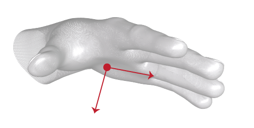

Vector com.leapmotion.leap.Hand.direction ( )
The direction from the palm position toward the fingers.
The direction is expressed as a unit vector pointing in the same direction as the directed line from the palm position to the fingers.
You can use the palm direction vector to compute the pitch and yaw angles of the palm with respect to the horizontal plane:
float pitch = hand.direction().pitch();
float yaw = hand.direction().yaw();
float roll = hand.palmNormal().roll();
Returns
The Vector pointing from the palm position toward the fingers.
Since
1.0

Vector com.leapmotion.leap.Hand.palmNormal ( )
The normal vector to the palm.
If your hand is flat, this vector will point downward, or "out" of the front surface of your palm.
The direction is expressed as a unit vector pointing in the same direction as the palm normal (that is, a vector orthogonal to the palm).
You can use the palm normal vector to compute the roll angle of the palm with respect to the horizontal plane:
Returns
The Vector normal to the plane formed by the palm.
Since
1.0
