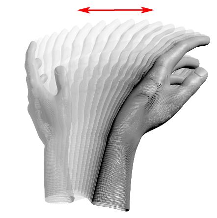

Detailed Description
The SwipeGesture class represents a swiping motion of a finger or tool.
Important: To use swipe gestures in your application, you must enable recognition of the swipe gesture. You can enable recognition with:
controller.enableGesture(Gesture.Type.TYPE_SWIPE);
Swipe gestures are continuous.
You can set the minimum length and velocity required for a movement to be recognized as a swipe using the config attribute of a connected Controller object. Use the following keys to configure swipe recognition:
Key string Value type Default value Units
Gesture.Swipe.MinLength float 150 mm
Gesture.Swipe.MinVelocity float 1000 mm/s
The following example demonstrates how to set the swipe configuration parameters:
if(controller.config().setFloat("Gesture.Swipe.MinLength", 200.0f) &&
controller.config().setFloat("Gesture.Swipe.MinVelocity", 750f))
controller.config().save();
